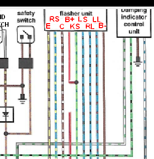

I guess everyone already knows how to eliminate the drain from the signal minder
But just in case
Just cut the RED wire and move it over to the LT GRn/DRK GRN

No.. Mrclubike. This is the second or third time I've raised this topic and this is the only time this info has been posted. Opened my Haynes manual though I'm not the best at reading these diagrams. Am I correct in thinking that this move would cut the flow to the hazard lights ? Would you know where is an accessible/easy place to perform this re-route ?
