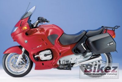

A 2004 RT with generic bags
Notice the much lower location of the exhaust on the RT, vs. the R1150R. The higher exhaust on the R1150R makes for a smaller bag on exhaust side. Some R1150R owners remove the exhaust can and install the RT generic bags, with the same sized bag on both sides. A stock R1150R exhaust will not support a RT bag on the exhaust side.
