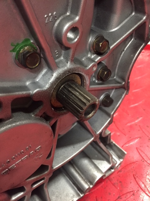

OK, back on it tonight....
Input shaft splines look great...
Used Honda M-77 Assembly Lube (used to be called Moly 60), on input splines and drive shaft, which I was careful to phase correctly...

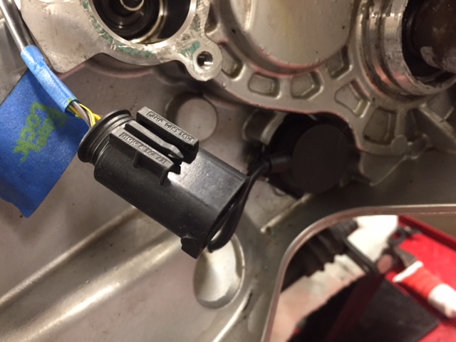

Swapped my gear position indicator for one for an RT, will explain this later...note the connector is different...

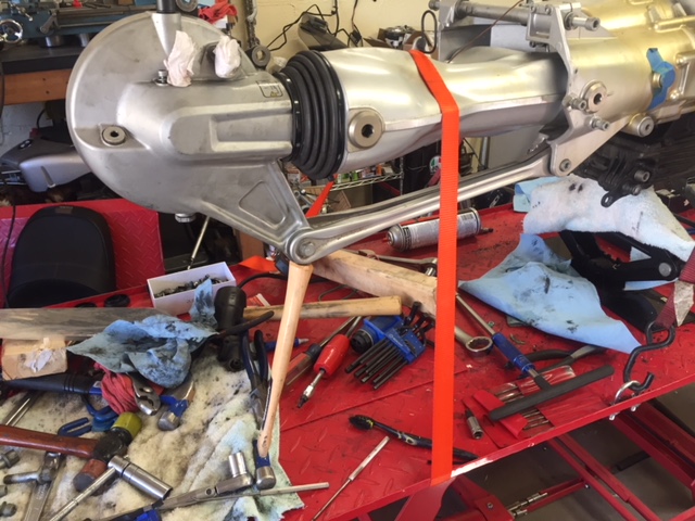

This is how far I am, includes the Paralever (loctited pivot threads) with drive shaft and top part of subframe and oil lines...

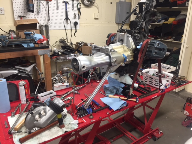

OK, back end drive train is all together, had to improvise a bit, I'm used to having the rear shock on my S-bikes when I put the final drive on, not with these bikes unless the rear subframe is on. The rear pivot has the Rubber Chicken Racing bushings instead of the roller bearings that came in it...

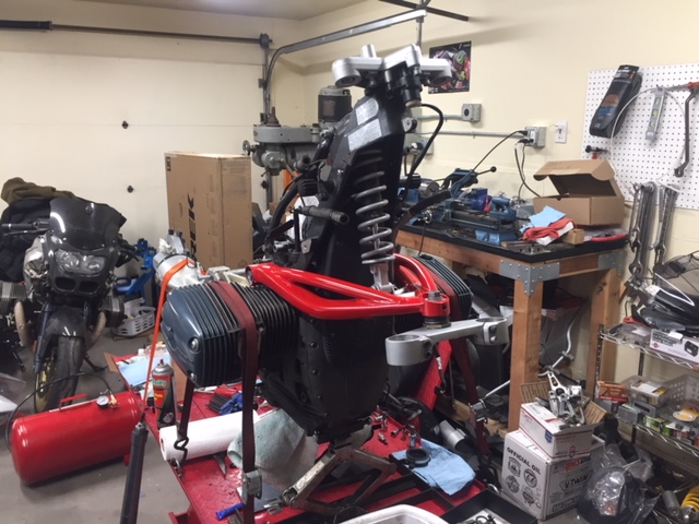

OK, started on the front end. Drilling out the security screws on the R took hours when it shouldn't. I need to find that damn drill bit sharpener I had in MD. Packed in a box somewhere. Bought some good bit's the S one only took 5 mins to get off. Used some regular allen screws to install S-bike ignition switch on R-bike upper tree...
Had some fun with paint today and started putting the front end together...
Need to order some o-rings and seals before putting the forks on, old ones are dry rotted and cracked...

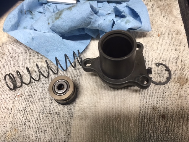

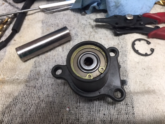

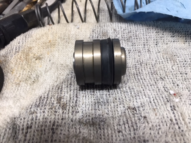

OK, back to work tonight, rebuild kit for clutch slave cylinder came in, thought it would be easy, seems the piston seal decided it should be locked to the cylinder wall. Nothing would pull it out of that cylinder. Its counter intuitive but taking a socket and hammering in released it and it pushed right out (spring behind it)...here it is apart, there're simple...that's the replacement C-clip in the pic, didn't use it...
Putting the new seal on is tight but it will go on, note the orientation, put that lip on backwards and it will leak...used some silicon grease I use on the brake caliper pistons, went right in...
Here it is all back together...reused the stock C-clip because I used a socket to compress the spring and that fancy new C-clip has those little protrusions on it and it wouldn't collapse enough with socket there to put it in. I would image if one used the clutch push rod to compress the spring, you could use the new C-clip...
Installed...getting a custom clutch line is proving more a challenge because of the banjo fitting on the slave cylinder side...

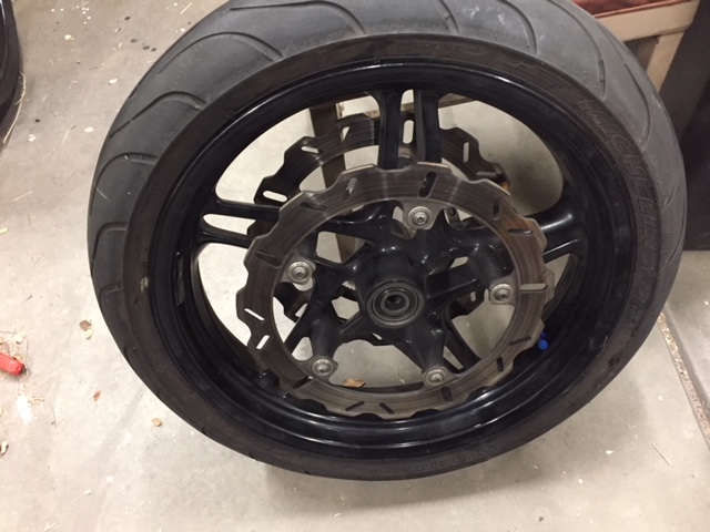

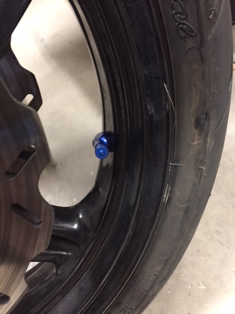

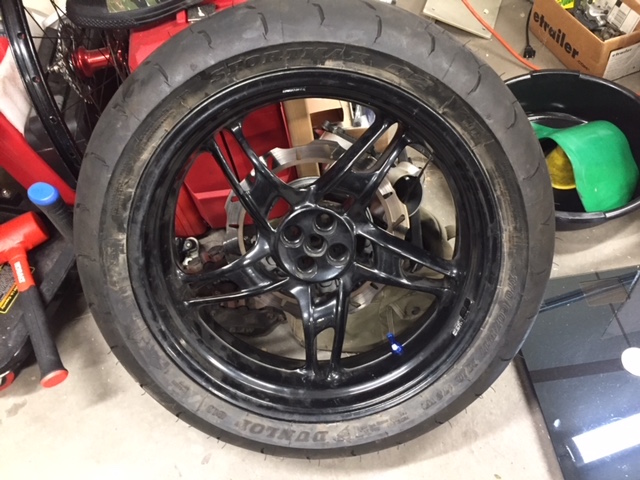

OK, finished building wheels up tonight. Took a while to post them, PhotoImage had a problem, has to be .cc now...
These are R1100S wheels from a 1999 bike that had ABS. Black powder coated with blue valve stems and Braking rotors (305mm to match my forks).
Front wheel with one of my older Pilot Powers, there's more tread in the middle than on the sides, if the rotors look a little blue, it's because they are, track days get you this hue...
New valve stems, these required some filing to seat property...

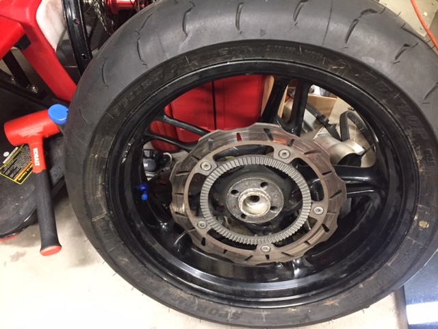

Pretty side of rear wheel, zero miles Q2 I had, its a 170 tire...
Braking rotor in the back too...

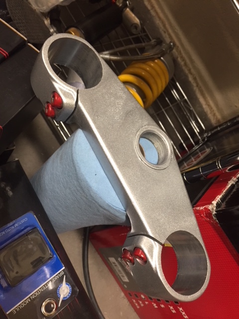

Painted lower triple tree (powder coat was coming off and rough), still waiting on new lower ball joint (correct one) from Germany - customs.... :-/

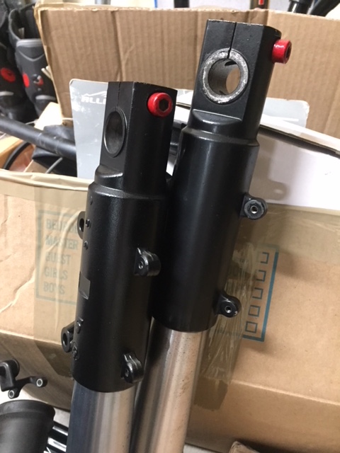

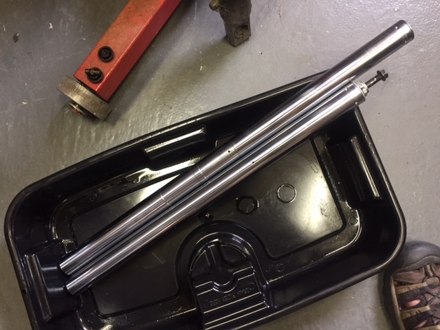

Had 4 fork legs to pick from, like the ones I painted with black epoxy, however, one of them had a broken off fender screw in it, take this as a lesson - DO NOT break the drill bit off in the screw, because you will then be SCREWED...so I pulled the other fork leg and painted the bottom to match...more PITA but better than the silver metallic by quite a bit...

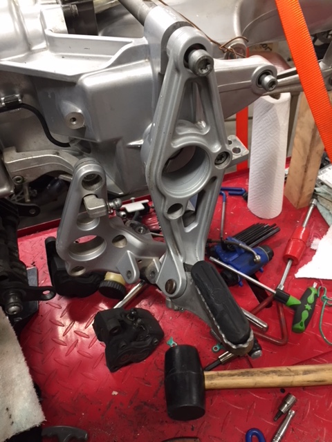

While the paint is drying, thought I'd have a look at the foot pegs and controls...compared the R ones with the GS ones and it appears the GS ones are about 4" lower (discounting the fact that the GS pegs are are taller than R pegs) and 3" more forward, not to mention about an 1" wider on each side and the side stand hits the GS shift lever...since the GS mounts move the shift lever forward, I'll have to use the GS shift lever, I'm going to go with custom Aluminum adjustable brake lever on the right side...
The brake side is quite different and forget swapping the R brake lever onto the GS foot peg mount, they're made entirely different, the R one mounts to the outside and the GS one mounts to the inside of the bracket and the brake master cylinder aligns differently...

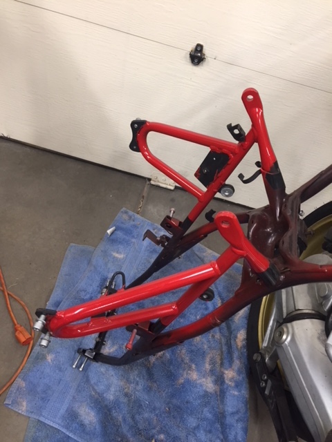

Doing some red accenting on the rear subframe since I'm waiting on parts for the front...ready to go on now, need to start harness work...

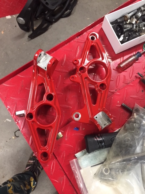

Here's the left foot pedal/controls on the left side - both R and GS...GS ones look more "technical" in my view...
Here's how they look in red...more accenting just because I can...

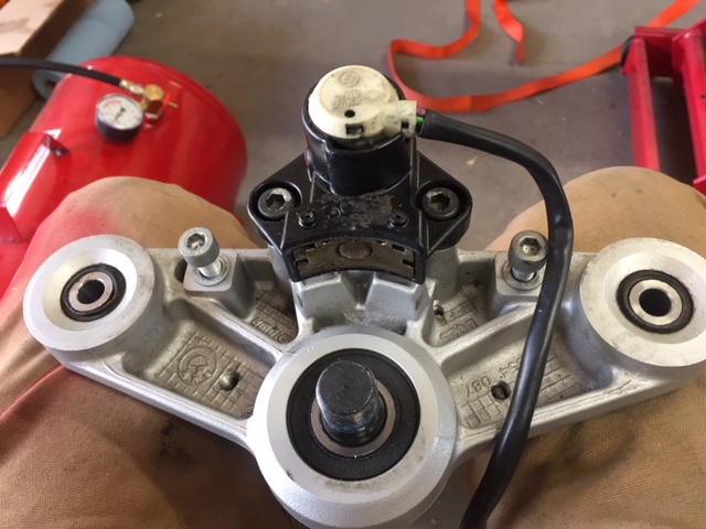

Lower tree still waiting on new ball joint but powder coat was hurting, so I painted it too...really don't like the silver metallic but it's OK on this part, got carried away and painted the clamping bolts too...tacky I know

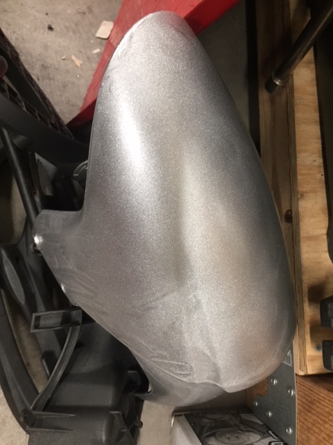

Front fender was black, sanded it, now it's silver metallic and I screwed up the paint, time to re-sand and paint with a better plain silver...can see it ran on the sides...
Black epoxy paint on fork lowers turned out nice...These are 1999 R1100S lower forks...new wiper seals arrived, these only use .17 litres of fork oil because they have a plastic cylinder that displaces about .2 liters...lots of speculation about why BMW did this on the earlier bikes but not on the later bikes, my speculation is it lowers fork inertia (tube is lighter than the fluid), I typically fill them up to a little bit below the seal (cover the upper slider bushing)...fail to do this and your upper fork bushings will wear out way ahead of schedule....
Since I kept the original upper tree, I have to have the upper stanchion tubes with stud, used ones from a set of GS forks I had...

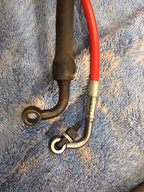

OK, still waiting on parts for the front end. New clutch line from Speigler arrived but there's an issue (their work is impeccable)...
I'll work it out with them...

Postby BadToTheBown » Fri Apr 27, 2018 8:46 pm

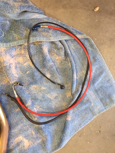

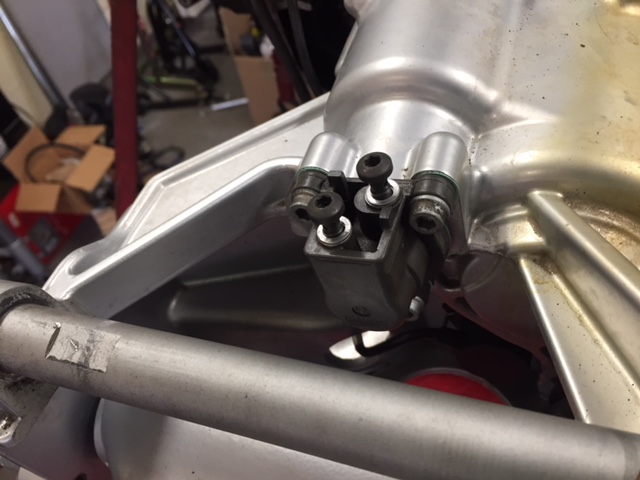

Good news is Speigler can not offer clutch cables for our bikes....

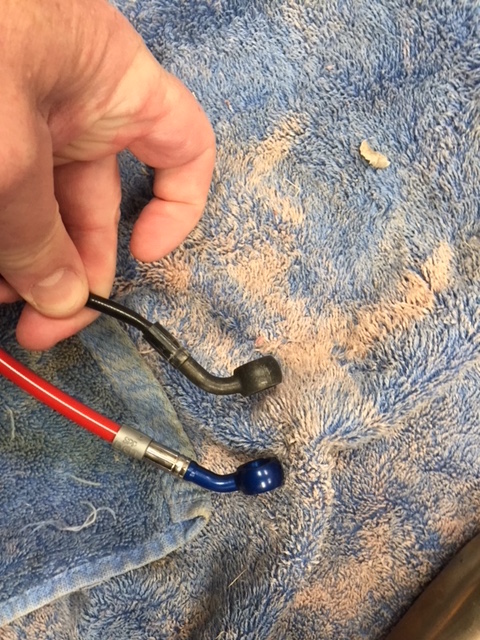

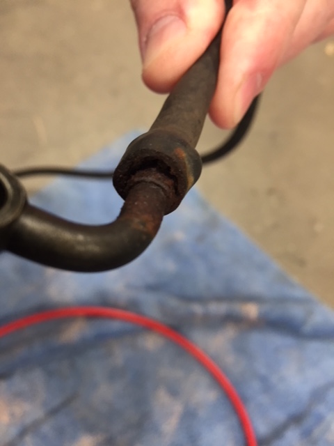

Clutch slave cylinder end...note the bulging rubber line...
Clutch master cylinder end...
This is why I need a new line...this was ready to fail...
Doing wheels next...
where did you buy the rebuild kit from?
