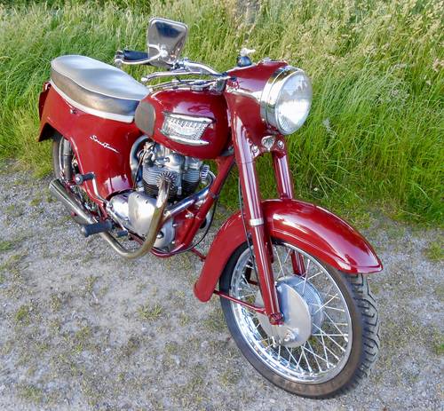

Pyramid Plastics is the maker of the Fender Extenda. A USA firm I believe. But I agree with our friend Riceburner that there's never been a proper mudguard design for a motorbike since Triumph's Dustbin Fairing on the Speed Twin :-
This is the list of people I'd trust with my bike
