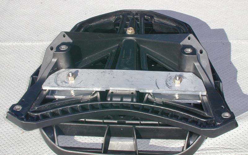

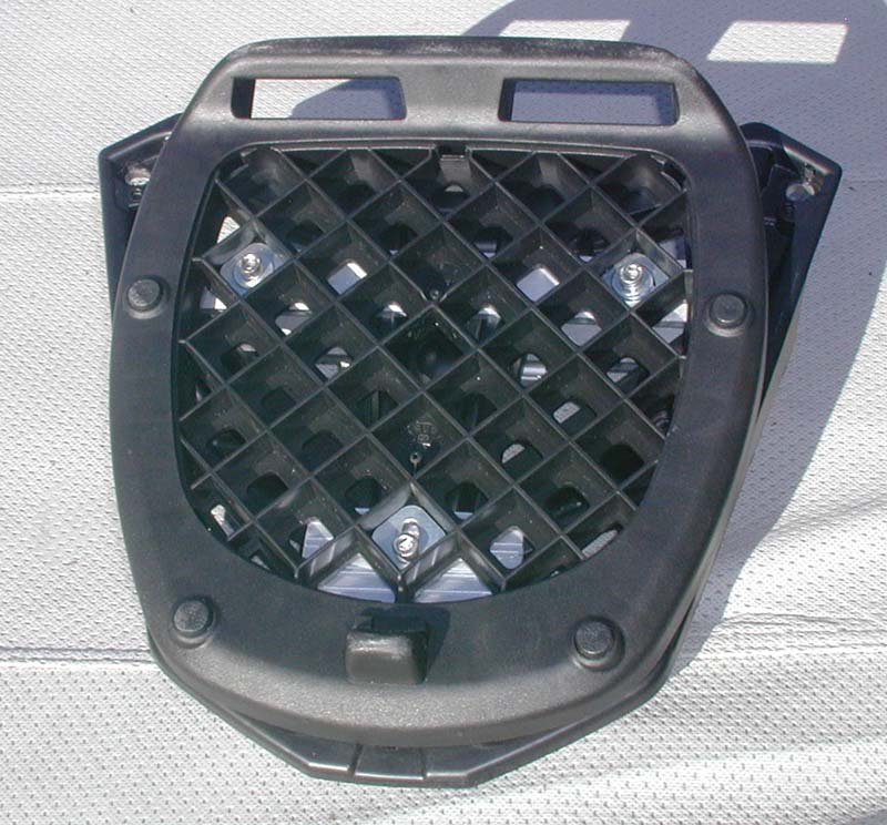

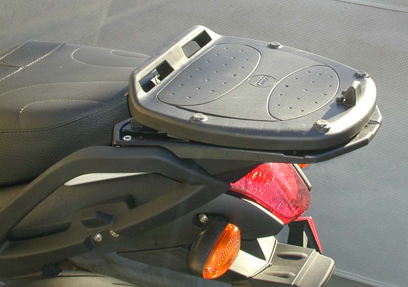

I have a Givi universal monolock type mounting plate on mine. This came with the box, an E20N. It is mounted on top of the BMW luggage rack. The mounting hardware that came with the kit does not work with the BMW rack, I had to fabricate some of my own parts and buy longer bolts to make it work. I used straps of 1/4 inch aluminum under the luggage rack, and 3/16 aluminum for spacers betwen the two plates. But now that it's finished, it is very strong.
Re: Give Topboxes
Here is the underside of the BMW rack. You can see that I cut the ends of a strap at an angle to fit into the recess under the rack. You can also see the relief cut in the center of the strap to clear the center rib of the BMW rack plate. I could have settled for making a slight bend in the plate, but I got fancy with it. Because the top of the BMW rack is not flat, I cut a strip of 3/16 spacer material and drilled it the same as the lower strap. A stack of fender washers would do the same job. It's just there to keep the two plastic rack parts from bending when you tighten the bolts. Three bolts hold the two plates together. There was an existing hole in the bottom of the BMW rack, I just enlarged it and put the third bolt there, with more spacer material between the two parts. Use locking nuts.
Here it is looking from above, with the trim removed.
Here it is mounted on the bike with the trim installed. I left the silver BMW trim part off because I didn't want to mark it up.

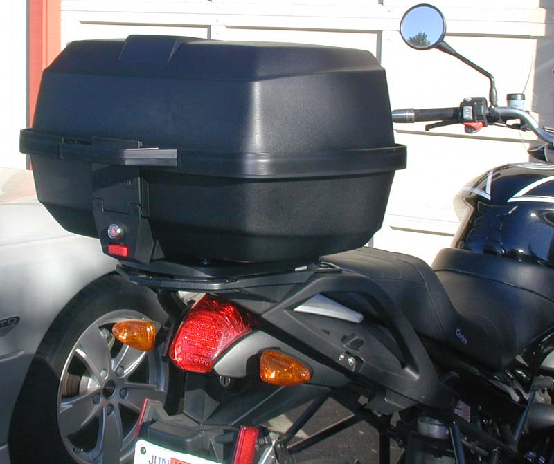

Here it is with the bag installed.
I like this Givi E20N case because it's light, and it holds a full face helmet with room left over for lunch. It's just slightly bigger than a saddlebag, they are 31 liters, this case is 37 liters. Perfect for commuting. Also the styling is plain, I don't like the other cases that look like the starship Enterprise landed on the bike. It was pretty cheap, about 100 bucks on eBay. It is strictly light duty, you wouldn't want to carry a lot of weight. But the same mounting plate can take a lot of different bags, if you want more capacity
