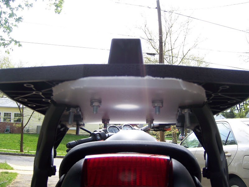

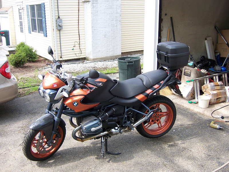

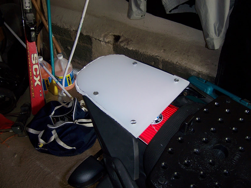

Nah! The cheap solution is a $10 cutting board and a $50 top case from JC whitney. Check this out
Think I did a write up on this somewhere on the board. I certainly stole the idea from someone else here. If not, happy to share all my pics with you, just PM me. Good luck!

Cool! Thanks for the pics.
What kind of case is that?

I did similar to jfSlater.
I used an old Givi box that a friend gave me for free! But I didn't use a lock plate - mine is just bolted straight to the flat plate.

I think using a base plate so a quick detach plate could be used on top is the way I would go... That way I'm not stuck with the case on the bike at all times and can easily remove it at my leisure.

Jpainter187 wrote:That's true. Is the plastic rear rack sturdy enough w/ only 4 mounting points to support the weight/vibration of a fully loaded, say... a 46 liter top case? I could fabricate something that would allow me to mount a top case directly to it but I would want to make sure that the rack didn't get damaged by the "home-made" mounts.riceburner wrote:Remember if you're using "just" the OE rack mounts - it's only held on by 4 screws - I can whip mine on or off in less than a minute, and have no unsightly rear-rack.
not sure about exact weights, but I've had mine set up this way for at least 3 years - IIRC my box is a 30 or 35 litre one (don't really know - it was free!) and I often carry a bag full of clothing in it (one of my old tote bags is almost exactly the right dimensions to drop straight in - very handy!)
Worth pointing out also that I have the box screwed directly to the rack supports (through the plastic base plate) and there's a metal sheet IN the top-box as well (see my pics : http://www.flickr.com/photos/rockburner ... 626780985/ ) that spreads the load. The box DOES move about a bit, but I check the uprights regularly and they seem fine.
I've only had the screws come loose once, this year, probably just because I hadn't done it up tight enough. (I take the box off every now and then).

So the plastic base plate on the tail rack (the piece that's mounted behind your seat) IS underneath the trunk? Or was it removed and the one that's mounted behind your seat the original. I'm just trying to make sure I am clear because from the pic it looks like the rear support arms on the sides of the tail rack are the only things underneath the trunk?
