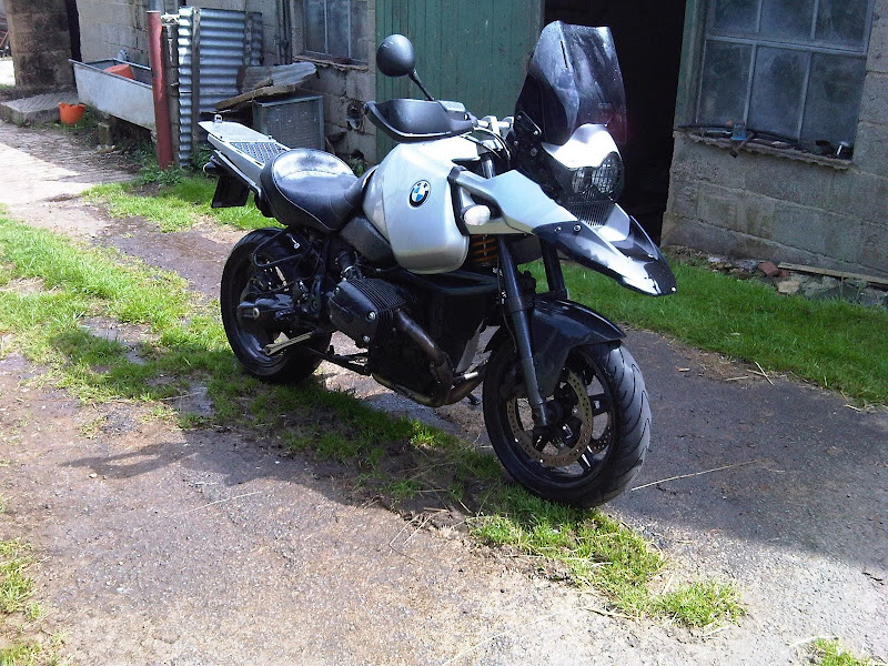

The kinship between R1150R and R1150GS really could be exploited! I'm fond of the Adventure, including the OE engine guards:
