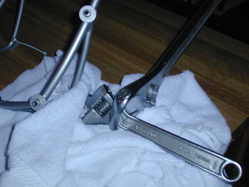

One question from someone NOT very mechanically inclined (seriously, not even remotely close) - what's the best method for bending the windshield bracket to line up with the screw holes on my handle bars? Are you bending at the flat portion or trying to bend the entire bracket "in" slightly. Don't want to goof it up. Note: using the Touring Bracket.
thanks for any suggestions.

I had a piece of 4x4 lying around. I put the whole flat section on the 4x4 and then pushed down on the bracket to slowly bend the flat section up a bit - all by eye and very unscientific - did both of the arms the same amount (again by eye) and then tried it out. Got it close enough the first time - I would guess about 1/2" of vertical change at the end near the hole. Still very happy with the combination - certainly not totally quiet, but then I have a 3 or 4 yr old Nolan N102, so nothing would be totally quiet - but it creates an envelope around me that is what I wanted for highway riding - 70 no longer feels like 90.BigSmile wrote:Special thanks to Don C for the quick shipping of the spacer block. Looks like flawless craftsmanship. The use of a crumpled up motorcycle publication for shipping paper was a nice touch also)

If you happen to have two big crescent wrenches around, 12 inchers work well, you can do this. Wrap an old towel around the flat part of the bracket, then put the crescent wrench over that and tighten it up. You want it close to the tube. Then use the second crescent wrench to twist the first one. With the two wrenches this is pretty easy. You want the lower loop to sit all the way down in the bottom of the hook shaped part of the support. Bending the flat parts upward will do this for you.

This may sound like a stupid question, but I have purchased the Cee Baileys windshield and the Don C plastic block, but I don't know how to install it:
Which part(s) of the windshield bracket does one bend when installing the Don C block?
The photos with the towels obscure the bracket piece that is being bent by the adjustable wrenches.
Do you bend the piece in front where the bracket attaches over top of the Don C block?
I apologize for being so mechanically inept. I just don't want to bend the wrong part of the bracket and then have to purchase a new one, due to my error.

Don't bend the bracket ahead of time, There is no need. Just put it all together and tighten down on the bolts that hold the bracket to the fork assembly. The bracket will bend as needed and you will get a nice neat finish.

It's the flat parts that go back to the steering head that should be bent upwards.
