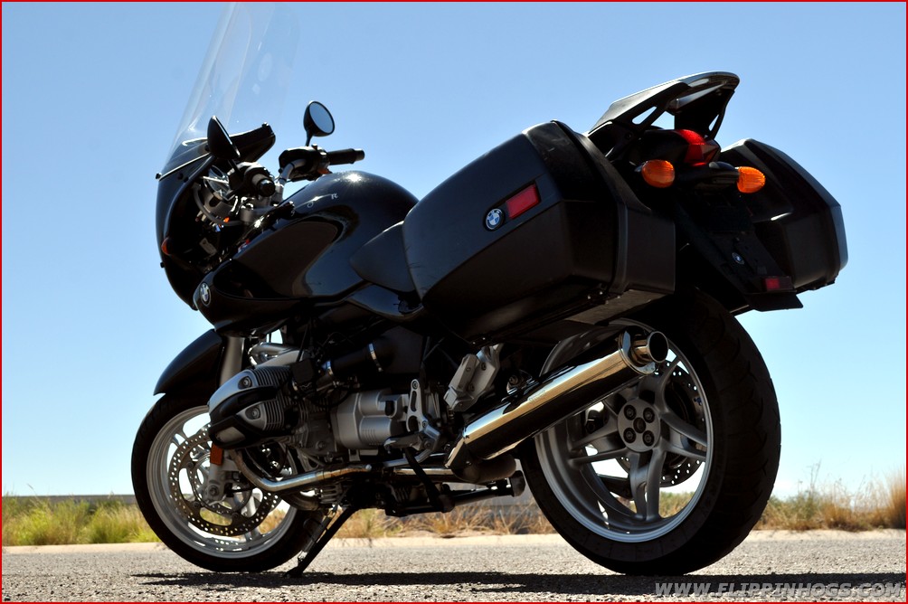

I'm building this R1150SR (I added the S for Sport) to get my old lady to ride with me more and on longer trips. She's NOT good with distance on either my R1150S or my Ducati Hyperstrada and the RC-51 is a non-starter. The ONLY bike she ever was able to get comfortable on was my Harley Ultra (fell asleep on the back once). So I decided she needed something like that if I was to get her to ride more and go distance. Found a 2004 R1150R cheap, non-ABS and not running. I do want ABS, I want it to handle more like my R1150S bikes (had 2 previously), want it lower than the S-bikes (there goes the handling), backrest and touring capacity is mandatory, cruise control (not a Throttlemeister), some go, etc. So I'm going to attempt to blend some parts from my former R1150S bike with this one to make an R1150SR. now if I could just figure out how to post my pics....

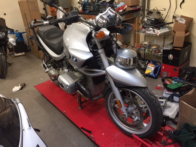

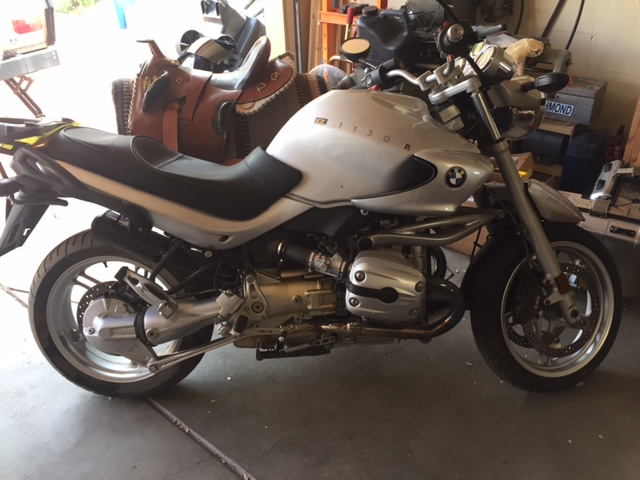

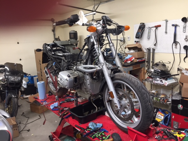

Re: R1150SR Project Touring Bike
Thanks for helping me. Haven't done this before this way...so we'll see if it works...
Bike as purchased...
Bike on the lift...she's halfway apart already (not evident in this pic)...
