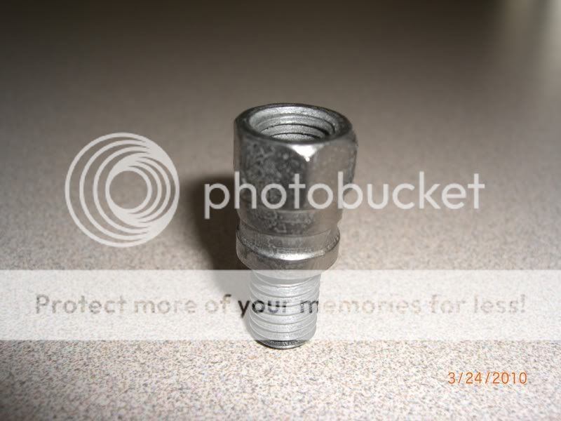

I replaced my mirrors with some aftermarket mirrors with LED turn signals. BMW has a setup designed to require you to replace the R12R mirrors with BMW mirrors, or at least I can't think of any other reason for it. The clutch/brake lever bases have a 10mm x 1.5m pitch and the adapters that thread into the bases both have a 10mm left-hand 1.25 mm thread in the upper part that the mirrors thread into. I know Yamaha uses a left-hand thread on one of the mirrors but it seems like other OEMs and most aftermarket mirrors use right-hand threads. I can see the sense in Yamaha's approach but not in having both mirrors have left-hand threads as BMW does.Image
I got a little mad at BMW and drilled out the left-hand threads and put Time-Serts in them so I could install the aftermarket mirrors. As with several of my R1200R projects, I don't recommend this approach unless you really like to screw around with things.Image

In case anyone is considering putting aftermarket mirrors on their R12R, I just came across thread adapters that look like they would work. They're 18-8 stainless with 10mm x 1.5mm male end and 10mm x 1.25mm female end. I saw them at http://www.mcmaster.com/#standoff-spacers/=agnqny. When you get to that page, you might have to click on "Thread Adapters & Spacers." The part number is 92499A712. They're a little expensive ($13.95) but cheaper than a Time-Sert kit.
