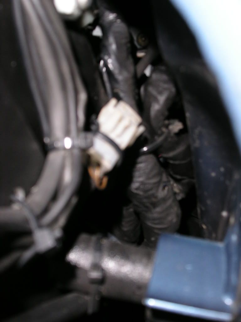

Martin can you expand on the re wrapping process and photo's if possible. Any tips on that would be appreciated. My 2001 is in tatters and need a fix. I was hoping to use Spiwrap but have not been successful in locating reasonable quantities.

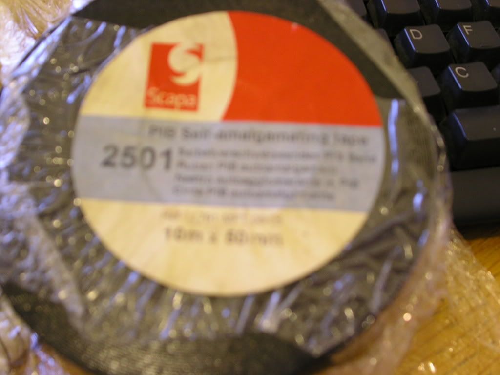

The tape I used I bought on eBay (for next to nothing for 2 rolls) but most decent hardware stores stock it. I used 50mm wide Scapa PIB self-amalgating tape.
What I did was to cut the cable ties, strip off the original perished covering, rewind with new tape and then re-tie it all back to the frame.
It sounds easy but it isn't. The SA tape has to be stretched lengthwise unitl the width reduces by about a third. The tape has a backing and this obviously has to be removed as the tape is wound round the cables. The SA tape sticks to itself (you should overlap by about half the reduced width) and over a period of time melds into a good, waterproof, protective layer. I suspect warm weather will aid this process.
Re photos, the areas I have rewrapped so far are all behind the sides of the tank and even though I can see them my photographic skills are such that I can't get a decent shot. FWIW here's a not very useful one of the tape as I have applied it and also one of an unused roll of tape.
The retaped bits are in the lower part of the photo but it is too blurred to be of much use I'm sorry to say. I might try again later to see if I can get a better shot for you.
