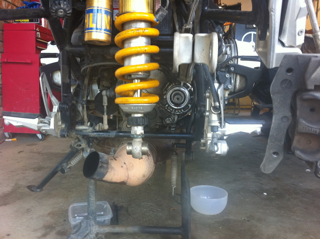

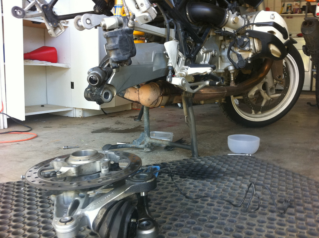

OK, while I'm stuck on my current journey waiting for a new clutch I get to replace on the road on my GS, I've decided to replace the $15 gasket on the roadster while waiting... But I need help, I have no service manual with me.... Can someone take some screen shots and send me jpegs or PDFs of the section pertaining to changing out the rear output shaft gasket?

Re: A little tech help please
Things are moving along, I'll have the swing arm off after one more run to home depot....
I could really use some help here, anyone have 5 minutes to look up changing the rear output gasket and make a few screen shots for me? At the very least, info on putting the swing arm would be kind of useful....
Great shot of the back end removed. Are you doing the clutch while you're in there?
No, no clutch.... Ive not worked much this year, too busy riding to work.... So it's not in the budget, and as long as it rides it wont be replaced.
With the $20 seal, $12 in beer, and $25 in a few tools I needed, it was a cheap fix.
Seal replaced, bikes back in action, lots of photos taken.
It really was quite easy to do, even with a sparse tool set.... Never thought I would need my camping axe for this job, but.... Oh the horrors!
