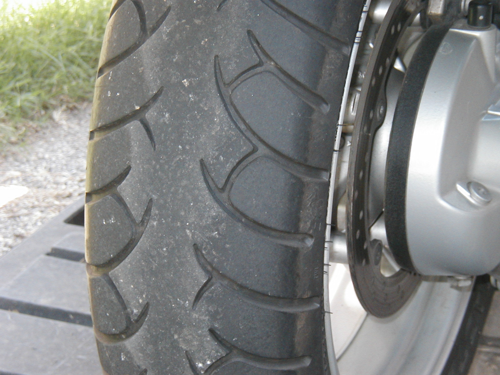

Latest update:
Here's a picture of my rear tire, now with about 10,600 miles. The tread depth in the sipes closest to the centerline now measures just a hair over 3mm. It is difficult to see the tread wear indicator - it is close to the centerline in the sipe nearest to the TWI" marking on the sidewall. In fact, I really can't see it - the only reason that I know it's there is from the tread depth measurement at that point (depth there is just over 1mm).
It's obvious that this tire is near the end of it's useful life but it does appear to have a few more miles left. Perhaps the relatively long life is due to being run mostly lightly loaded (I almost never have a passenger). I'm also not a very aggressinve rider, as the still pristine elephant heads indicate - this also probably contributes to longer tire life.
Charlie
Charlie
