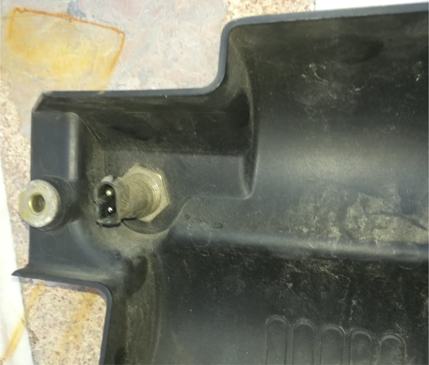

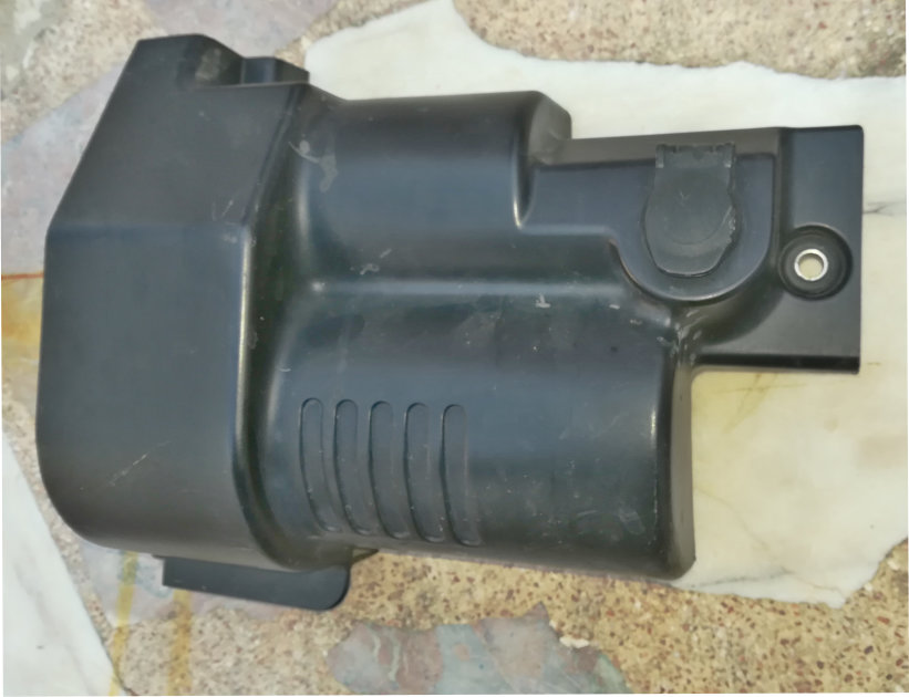

The OEM Aux Power Socket should already be on the Starter Motor Plastic Cover with its own little spring-loaded flat to keep out the weather- viz:-
...and there should also be a two-pole socket wired into the starter motor cabling to fit onto this plug at the back of said Cover - viz :-
Note - when messing with that cover and ferkling your fingers behind to connect up the plug to the socket, before you re-attach the cover, beware of the little rubber grommet that the locating peg for the cover goes into, set into a hole in the crankcase. It has a habit of trying to make a dash for freedom, bouncing into the darkest corner of your garage. A replacement grommet is unobtainable except from the Greedy Berlin Pig.

sykospain wrote:The OEM Aux Power Socket should already be on the Starter Motor Plastic Cover with its own little spring-loaded flat to keep out the weather- viz:-
