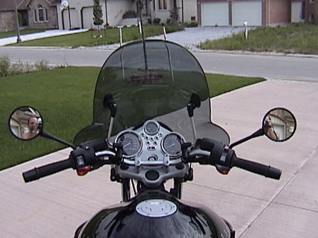

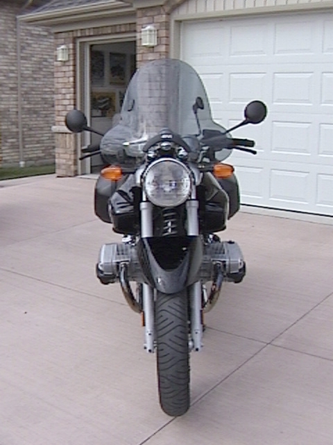

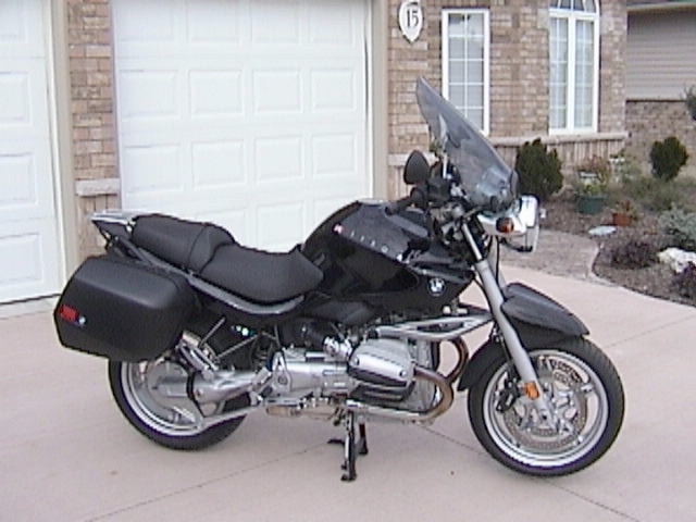

"I too was less than happy with the BMW windscreen that I had installed on my R1150R: at 70 mph the wind hit my helmet to hard that my neck would ache from fighting against it. Before resigning myself to throwing it away and buying another shield, I tried this fix: I removed the top 2 mounting bolts for the screen, substituted longer bolts, and added spacers in the form of little rubber o-rings. This canted the shield upward slightly. And it works great! My problem now is staying under 75 mph. Here are some pix to show the new mounting bolts and o-rings, and some views of the bike to show that the screen still looks good in its new position." -s2pidduncan
Pic 1
Pic 2

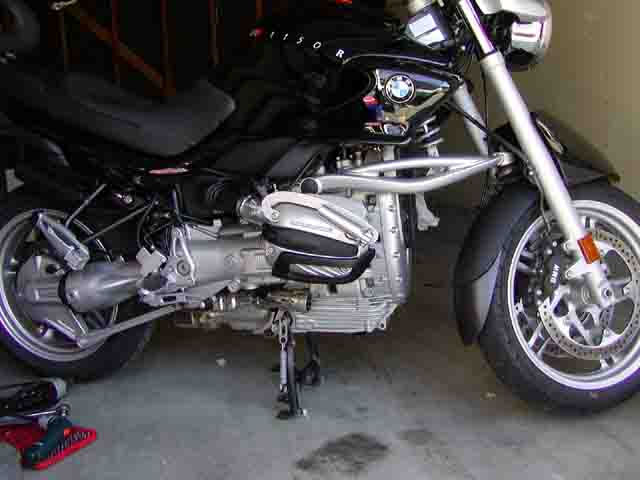

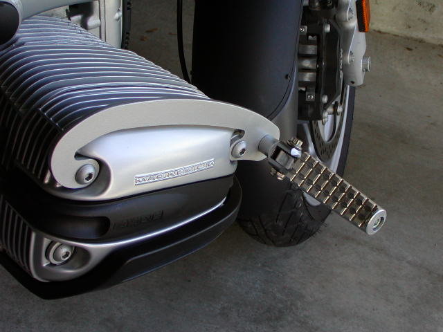

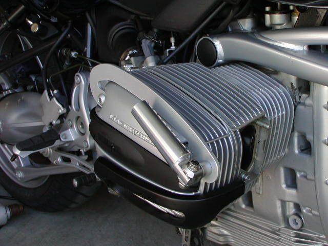

Gene writes: "Just installed my Highway Pegs so here are the pictures. The first picture has the parts and parts numbers. Cost for everything was about $120. I put some special bolts thru the Clevis that were from a high performance auto parts store. Also you need the Harley-Davidson friction clip that you can just barely see.
I have asked Burton if he would route out the mounting holes in the bracket so that I could slip on and off the pegs when I didn't want them. He is going to experiment."

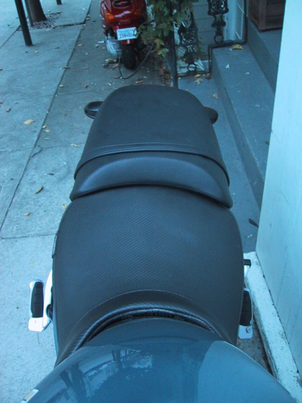

Corbin Seat pics here: 3Quarter.jpg side.jpg top.jpg. (Ps- Here is a link to the New Corbin seat. Its the best one I've seen yet!)
Greg M. writes: "It's hard for me to really know what the pros and cons of this seat are as I bought the bike used (six weeks old) and the previous owner put it on. So, I've never ridden a stock seat. This seat was custom made at the Corbin factory. It uses the original base pan. The owner said they wanted to keep his bike for a week and prototype it for the future release of an R1150R seat but he declined as he rode it daily. He only had the front seat made as he would never be carrying passengers so, the back seat is stock. I wish he had as I do and the hardware would be there for a backrest which my wife would really love! All I can say is, I find it incredibly comfortable! I can't benchmark it with the stock all I can say is I feel moulded to the bike, this puppy was made for me. Oh, tech heads might want to know I'm 5'9, 170lbs(fluctuates ;^) 32 inside leg, (can put feet flat at lowest point, pads of feet at normal seating position, 34" waist, shaved head and a wee goatie thingy. I've just joined the ranks after being an airhead for a while '86 R80. I loved that bike, but this ones feels like an airplane. If any one has any questions, feel free and drive carefully out there...

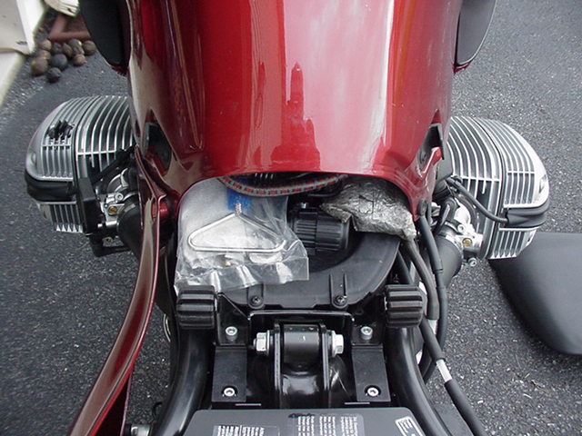

Cyclerob also Relocated the charcoal canister to the Non-ABS space under the fueltank! It fits there in the exact same position & orientation as on the tail section to not alter any functions. He then bought the BMW system city cases & they have a bulging relief into the bag volume just for that cannister that's not there anymore. C'est la vie.
Here are some of his other cannister re-location pics:
One, Two, Three
