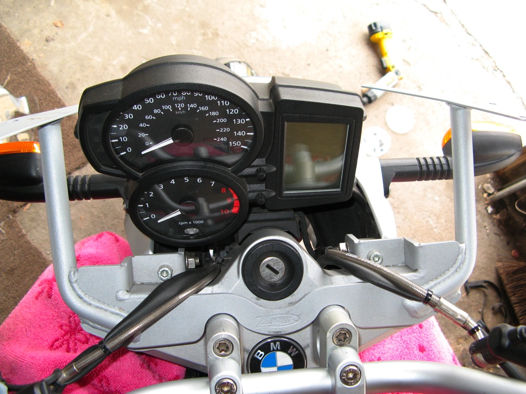

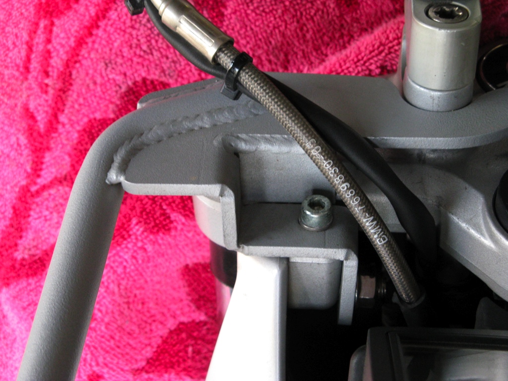

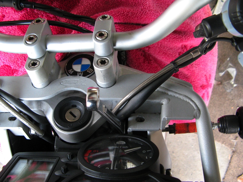

You can use Verholen bar backs, but you'll have to trim the windscreen mount just a bit so it will go around the Verholens. You can use a Dremel, or you can take it to a machine shop and they can do it with a laser or water-jet cutter.
If you have the patience, a Dremel will work fine.
Re: Ztechnik wind screen with Bar Backs
Mine works just fine with the bar backs I took off my R1150R.

I got in touch with Moto Techniques and they are certain their bar backs will work with Ztechnik.
Thanks very much for the pictures and info....without your help I would still be looking.
