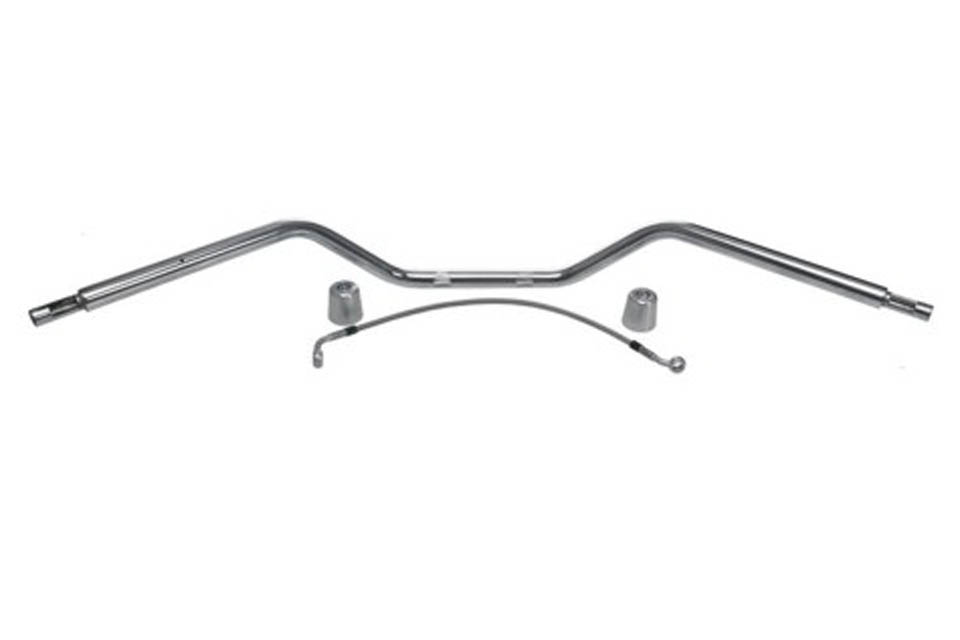

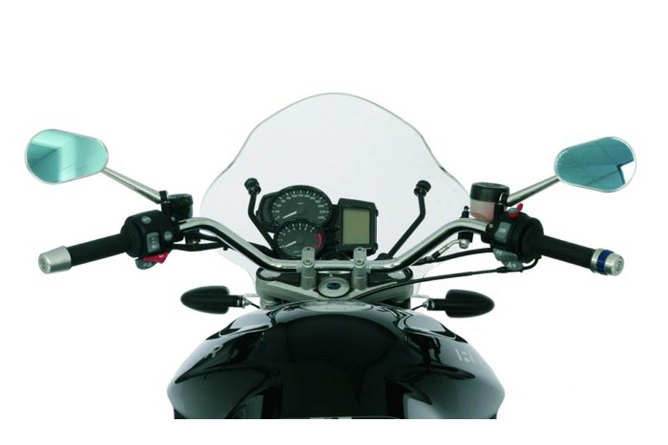

Due to neck arthritis I was looking for a more upright riding position than that from Wunderlich touring bars + barbacks. I found Rob at tharengineering.com who already made adjustable bars for sport bikes and was happy to design and make some for my R12R. I've adjusted mine a little taller, narrower and closer than than the prior bars. It's made a huge difference in rider comfort and a little finer control with narrower grips. I already had a longer brake cable but whether it's necessary I'm not sure. But risers are necessary with the current design. I had to drill the holes for the left grip screw. Rob machined thredded ends to accomodate the BMW barends. If anybody is interested I can e-mail pictures (communicating with i-phone and don't think the site will recv pics) or look at the thar eng. site as he's going to put up pictures I took.

As promised, images from Toby6938. Thanks for sending them!

It's not pretty, but I hope it will be far more comfortable on long rides.
