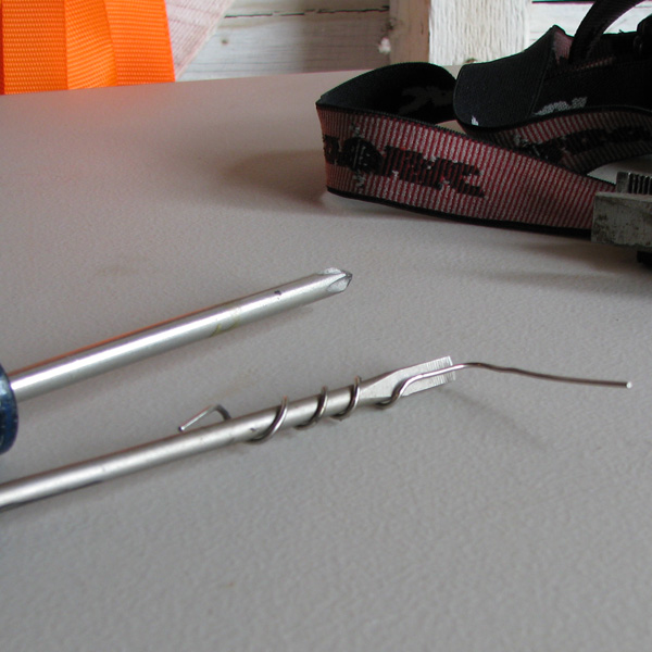

It definitely works - I've recently R&R'ed locks from two 49L and one 28L cases. The slot is not really that far from the lock and there are some notes on that page about how the newer cases are. In my experience, the 28L was the easiest - once I had created my tool and got a feel for it, the lock in the 28L cases popped right out.Bigg-Brother wrote:Thank you.
I saw this post already. Did you use these on 28L top case?
When I looked through the opening, I did not see same features - just a simple slot and it looked far from the lock.

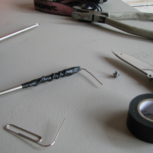

Make sure you make your tool stiff enough. The first tool I created based on his design was too flexy. Check out out how I wrapped the paperclip around the screwdriver and braced it against the flat area. Also, check out the length of the piece that goes through the slot.
Then I taped the crap out of it to keep it from moving.
Like I said, the 28L was super easy - I could take that one out and put it back in all day long. But I sold it to another dude who took it to the dealer to have it rekeyed (I kept my lock) and they screwed it up somehow and had to give him a new case.
The 49Ls were trickier - one was really tough to get just right. But what that page says is true - once you get the location right, the effort to pop it is almost nothing. Follow those instructions and be patient.

New bike, New cases, two different keys. I took the bike and cases home and did it my self using the link above. No kit, it happened that 3 of the tumblers or wafers matched up with the bike key. I just removed the ones that did not. Works perfect.
For the tool, I used TIG welding rod 1/16".

Thank you all for advise - I will make this stiffer tool and see if it works this weekend.

Success! Lock came out and now I have top case on my new RT!
That screwdriver tool worked great - took me 10 minutes and I was done!
