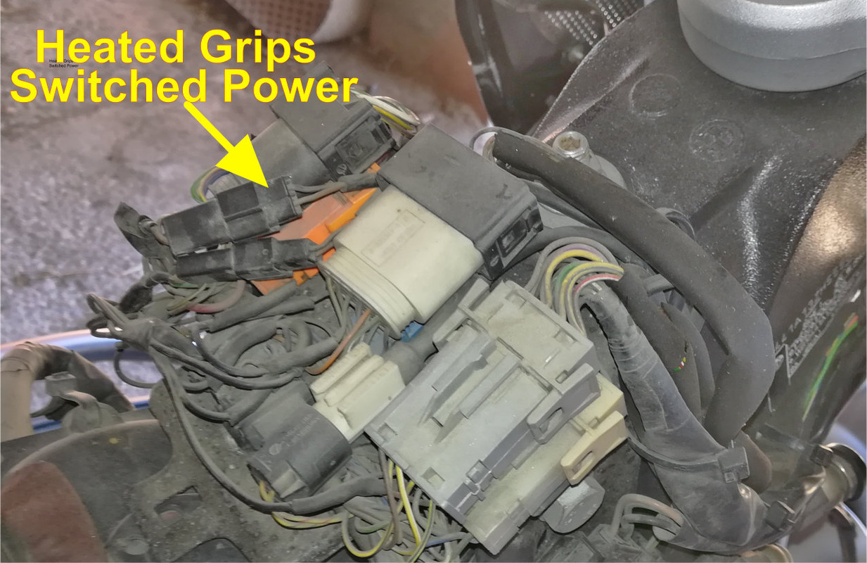

Seriously, coming off the white connector strapped to the top of the backbone are 2 short feeds to 2 separate black twin-wire connectors. Those connectors are switched by your handlebar 3-position HG switch. That's where you play about with your voltmeter.
https://i.postimg.cc/XvQ4cx8Y/Mo_GSA_Un ... ectors.jpg
