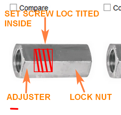

Re: Alternator belt and a chirp
Just wondering if this would work for the special tool
It is just a 8mm threaded rod coupler with a set screw (grub screw) loctited inside
Since I have not done this yet I do not know if their is enough room to just leave this under the front cover in place
One end is the special tension tool Then after you adjust it Just flip it around and leave it in place as the locking nut

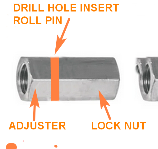

Another option is to drill a hole thru it and install a roll pin
