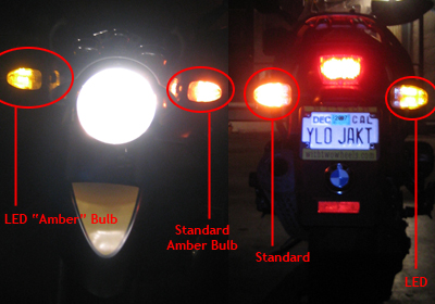

OK...I installed the LEDs tonight, and have mixed feelings.
I bought the "amber" colored bulbs, but the light cast is closer to yellow, which was a pleasant surprise (it matches my Yellow Jacket). :P
I also like the fact that the bulbs are clear (white) when they are off, so paired with my Clear Alternatives (clear) turnsignal lenses they look a lot cleaner than the amber-tinted standard bulbs.
The problem is...they are about half as bright as the standard bulbs. After installing and being extremely pleased with the BRAKE! LED brake light, I guess I was expecting a higher level of light output.
Oh well. I've attached a picture so that you can judge the difference for yourselves.

In retrospect, I think the reason the these particular lights are not as bright as the BRAKE! cluster is that the bulbs are positioned around a cylinder, which difuses the brightness and reduces the optimal viewing angle a bit (even with a reflector).
